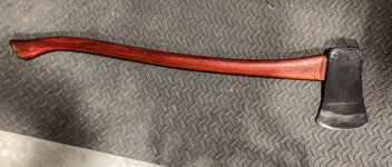

Here's one of my favorite axes: A Plumb All-American in the Michigan pattern with a 3.5-pound head. This one dates from about 1970. The handle is that lovely red color and still in perfect condition, mounted using Permabond epoxy.

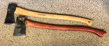

I have a complete Plumb family. Here's a Dayton-pattern Boy's Axe with a 2-1/4-pound head and a 28" handle, also Permabond, and about the same age as the felling axe above. This one needs a visit to Mr. Sharpen :) Along with it is a Plumb Boy Scout hatchet from a little earlier. This was mine when I was in the Boy Scouts, but I seem to have this memory that my father had bought it earlier and used it a while before trusting me with it. He probably had visions of emergency-room visits and soaking up blood out of the floorboards of his car. He would not have been wrong.
My one expensive axe is a Hults Bruk Kisa, which could also be considered a boy's axe with a 2-pound head and a 26" handle. I'm showing it here with the Plumb Boy's Axe for comparison. The Swedes have done a good job of marketing. These are great axes, but they are not better than the classic American axes of days of yore. They are the best traditional axes currently available, however, and they come sharp out of the box.

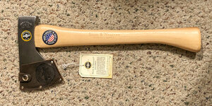

This is a Snow and Nealley hatchet that I actually bought new, but have not yet sharpened (and it did not come with even minimal sharpening):

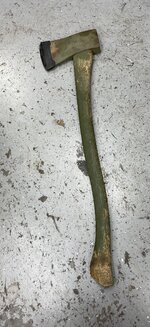

This barn-sale special ($5) turned out to be a Jersey-pattern Collins Homestead—a budget model back when budget models were no real compromise, now on a fresh Link handle:

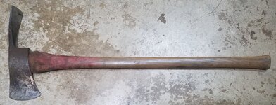

I went to an estate sale Friday. One of the items I found was this True Temper Pulaski. For those who don't know, the Pulaski was developed as a multi-purpose tool for fighting forest fires. It doubles as an ax and a hazel hoe, so it can cut up small trees and brush, and also grub out a fire line to bare soil.
This one is marked "TRUE TEMPER" "FLINT EDGE" and "KELLEY WORKS". It is in very good condition, with the handle a little loose from shrinkage, but the original wooden wedge has not been driven in below the end of the handle. The handle has some traces of red paint (many forestry fire tools are painted red), and is smooth from being used. I call it "honest wear", that is really a polished surface.
I'll bet that if this tool could talk, it could tell some tales!
